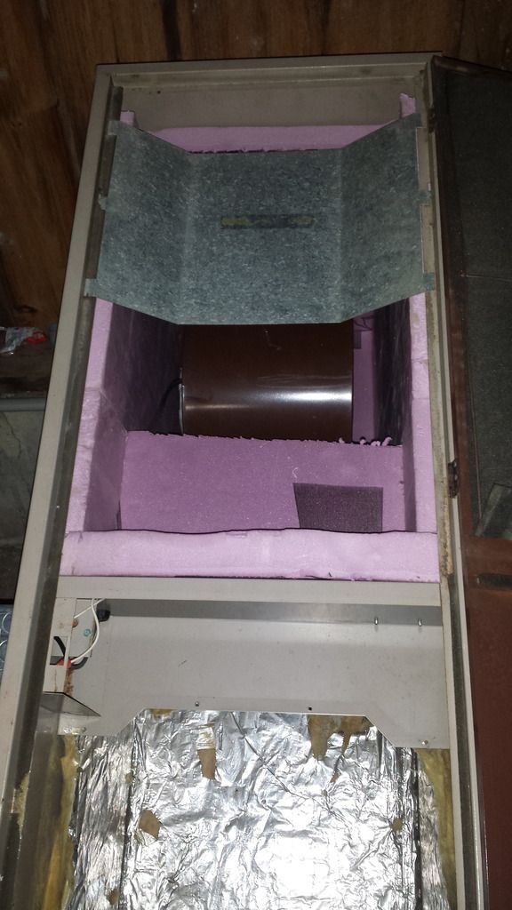

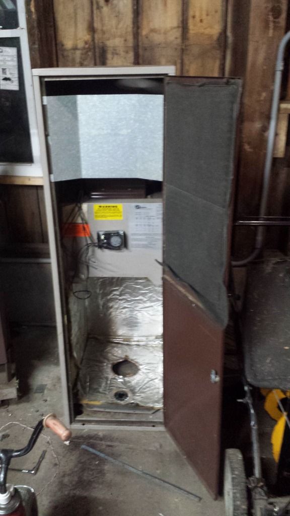

Boiler's been going great, picked up a miller mobile home furnace to convert to heat for my barn. Ripped out all the heat exchanger parts and am working on re-routing the outlet of the downdraft to front outlet.

Put a water to air hx under the blower fan where the old propane hx used to be then duct the hot air out under that through a new vent either in the door or side. I may shorten the door and put a permanent vent under the shortened door.

Thats what I did in the shop, took an old down draft, mounted an HX in it and relocated the filter rack, tis nice to just change filters instead of having to clean the HX. Do a lot of welding and plasma cutting in the shop so always a little smoke settling on stuff.

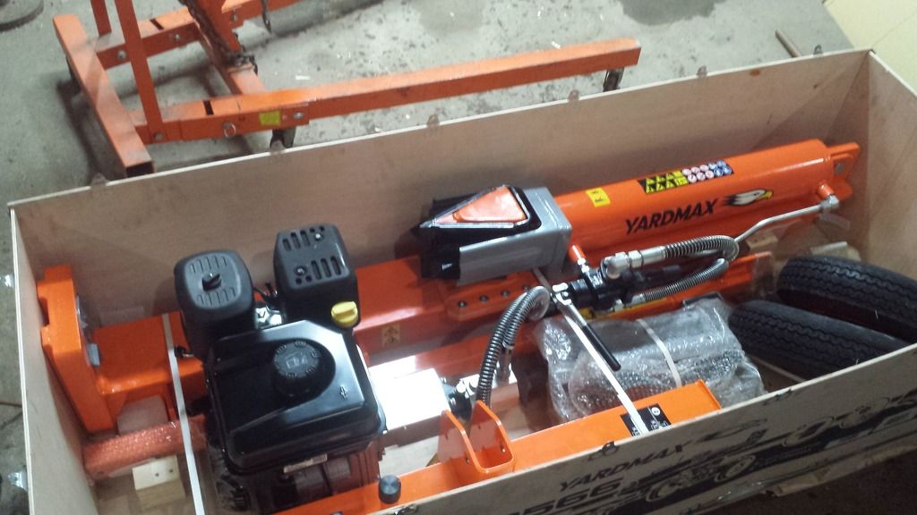

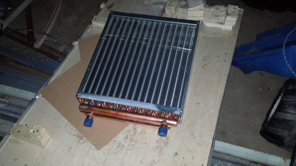

Finally got the log splitter put together and ran it for about 20 min to get some more wood split for the week. I've got the day off Friday so I'm planning on getting everything that I've cut to length split and stacked. I also ordered a heat exchanger online for the miller furnace. Should be in tomorrow and I've got some free time tomorrow night, so we'll see how far I can get on getting the heater setup. Seems like I'm going through about 1/3 of the wood that I was last year, we'll see if that keeps up though the winter, but it's been much colder this year than it was last at this point.

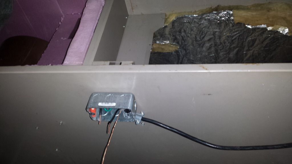

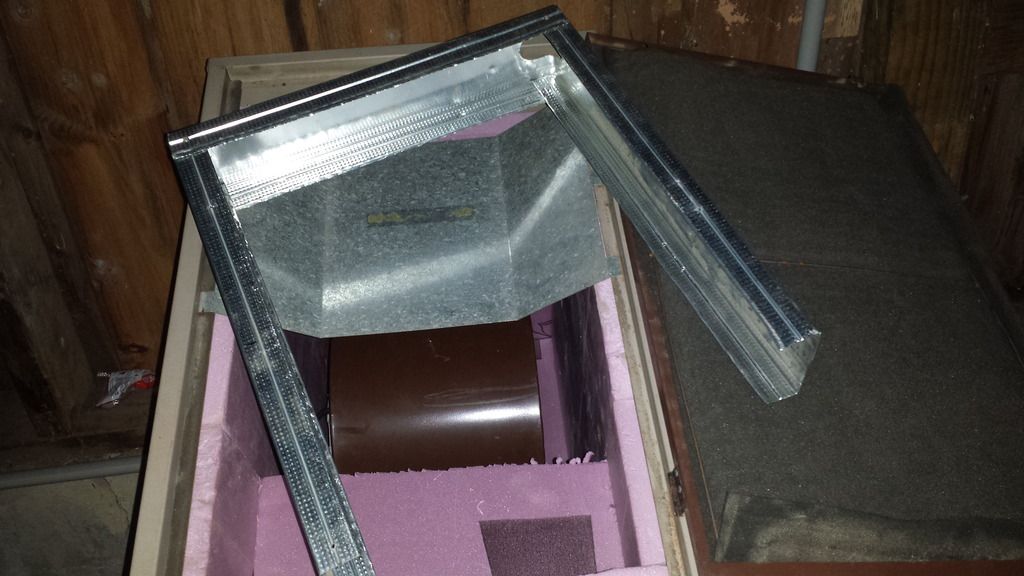

Gutted the Miller furnace I bought a couple weeks ago and started working on mounting the heat exchanger and wiring it to have a switch. I may wire it to a thermostat someday, but this year an on/off switch will have to do.

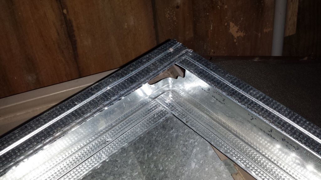

Made a bracket for the heat exchanger to slide into. I'll have to cut a slot into the side of the furnace housing for this to be riveted into, then the heat exchanger will slide into it with the copper fittings on the side sticking out.

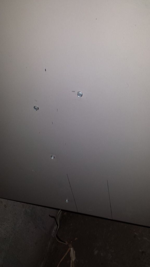

The markings on the side are where the slot will be cut for the heat exchanger bracket
