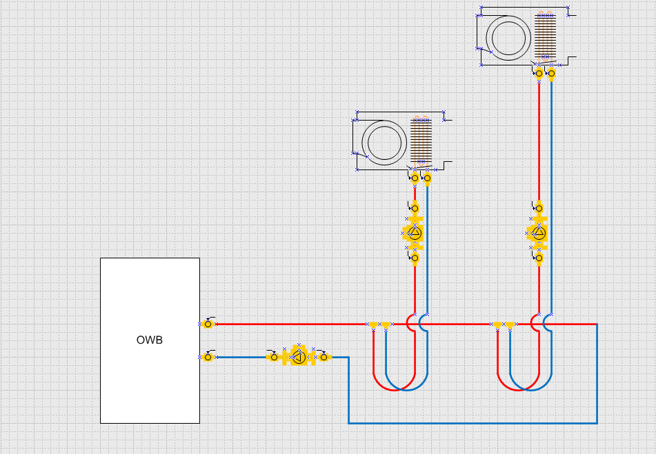

How about a couple closely spaced T's and a circulator with a check valve on the supply side and a check valve on the discharge side.  If you drop the lines going upstairs a couple feet down off the header before going upwards that would create a heat trap and eliminate any need for zone valves at all.  Something like this perhaps:
This allows you to zone each exchanger via the circulators, you are not forced to run though the downstairs unit to supply the upstairs unit.

I used visio, I have semi-copied most industry standard hydronic icons for different devices.
If you need/want me to draw something out for you let me know.   :thumbup:
