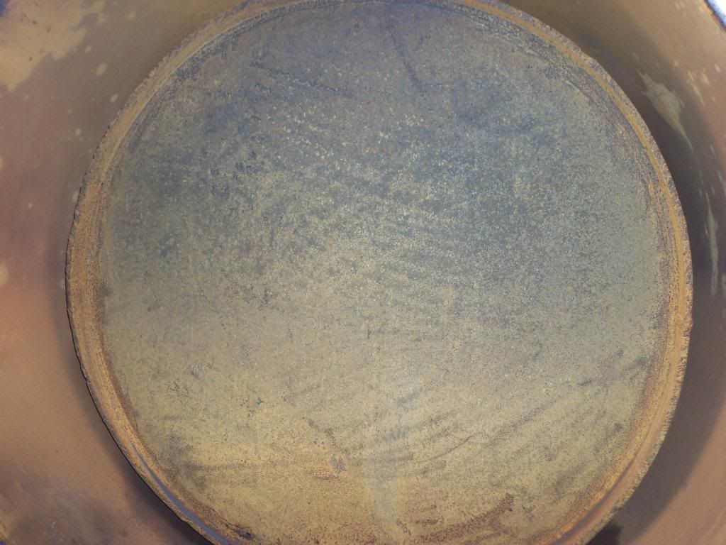

here is a photo of my home made stove (if it works) of the inside after 10 years of use. the fire box failed at the bottom due to me using firebrick that was used and i found out later they were used to line an acid pit (dumb luck)  but if you look at the walls of the water jacket and anywhere else  on the fire box that the brick did not touch there is almost NO corrosion of any kind...10 years...idle all summer..well water and no treatment ever used
and upon inspection of the failed part of the fire box...all corrosion appears to be from the inside of the fire box out to the water side
http://i67.photobucket.com/albums/h308/billie_boy7/inside%20the%20bullet/017-2.jpg
and after ten years of running with this stove the originall taco 11 is still running the replacement stove
« Last Edit: April 09, 2014, 09:12:56 PM by willieG »

That's pretty cool, and unfortunate about the bricks. Do you think your water conditions apply to everyone's water?
