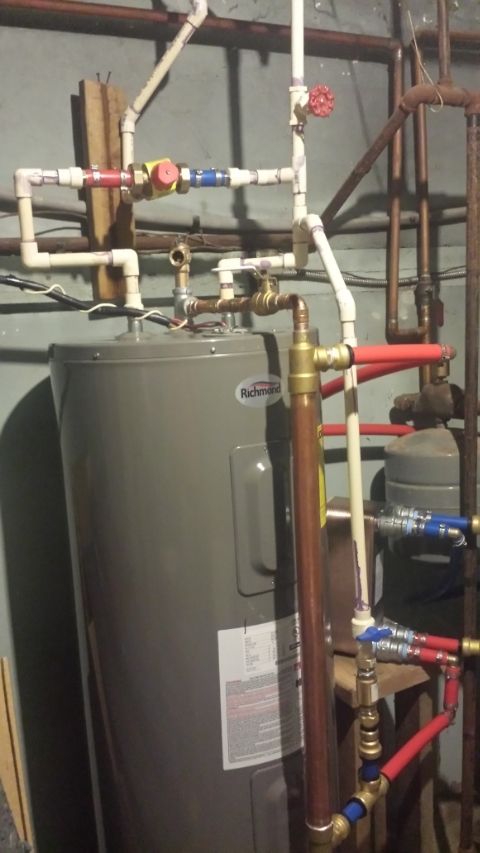

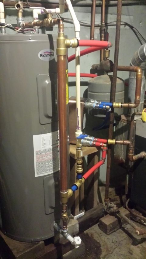

« Reply #7 on: January 01, 2015, 08:15:17 PM »
Something caught my eye about your diagram, and it may just be the terminology but you already have an LP boiler which would be a closed pressurized system correct? But in your diagrams your getting your hot water from the boiler then returning it to the furnace? The Ridgewood will be an open system, you need at a minimum of a 50 flat plat heat exchanger between the open and closed systems so your closed system stays closed.
Yeah, the diagram was only referencing that the water was continuing onto the furnace. (which is indeed a closed system, and utilizing a 300,000 btu plate exchanger)
During the install today it became very obvious that I need a new water heater. I came to this decision while cleaning up 40 gallons of water that had blown out of it. How you ask? Well, I started off by hooking up a garden hose to the drain on the bottom of the tank and routing it outside the basement into the lawn. I then opened the valve expecting to see the water rushing out.... trickle, trickle, drip, nothing... mmmmkkkkk, must be the valve is not actually opening? Nope its not the valve... So I do the unthinkable, knowing fully well it was a bad idea, I remove the drain valve and stick my finger into the hole, which punctures the clogged up sediment and rust, releasing 40 gallons of regret all over the basement.  :bash:
The tank was in such bad shape in the bottom of the tank that I have decided to just replace it.
Headed to the box store in the morning to pick up the new water heater and continue the installation process... pics to come.
Thanks again for all the help guys.

Got her installed... water is getting up to temp as I type this. It has been a crazy, frustrating last couple days, and I'm thankful to only need now to insulate the pipes, and turn up the thermostat. Thank you all again for the help.
