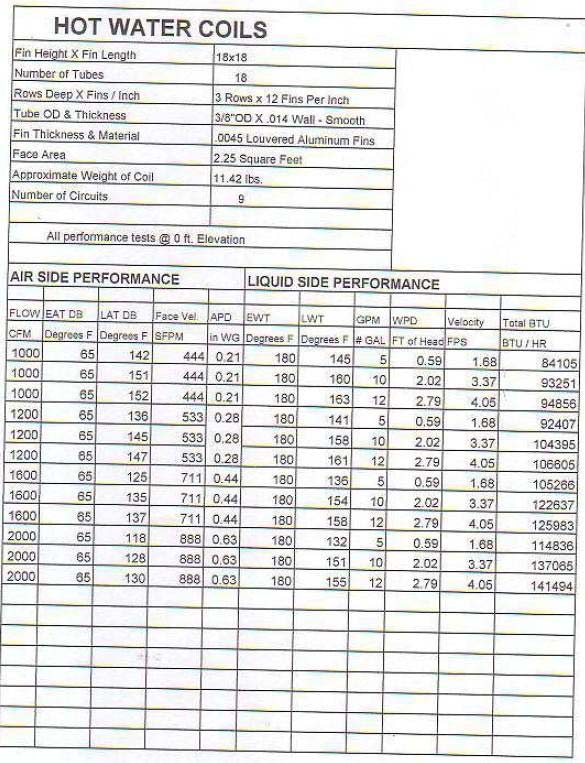

I really doubt a 40 plate will be anywhere close to 12ft of head loss.
I posted a chart above for a 18x18 heat exchanger. It is around 2.5 feet of head loss at 12gpm.

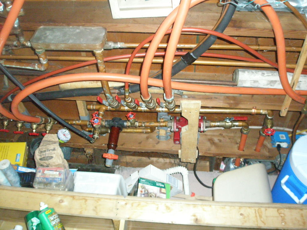

Here is a picture of my setup. It was done about 8 years ago. The water is being split and the PL-36 is supplying more than enough to every loop. The 1/2" pex is for the dryer and it is flowing continuous right now. I have an Asco red hat solenoid valve on it but it seems to have failed. (supposed to only open when the dryer is calling for heat)

RSI,is that chart for a water coil that goes in a air plenum? Doesnt look like a flat plate chart.
