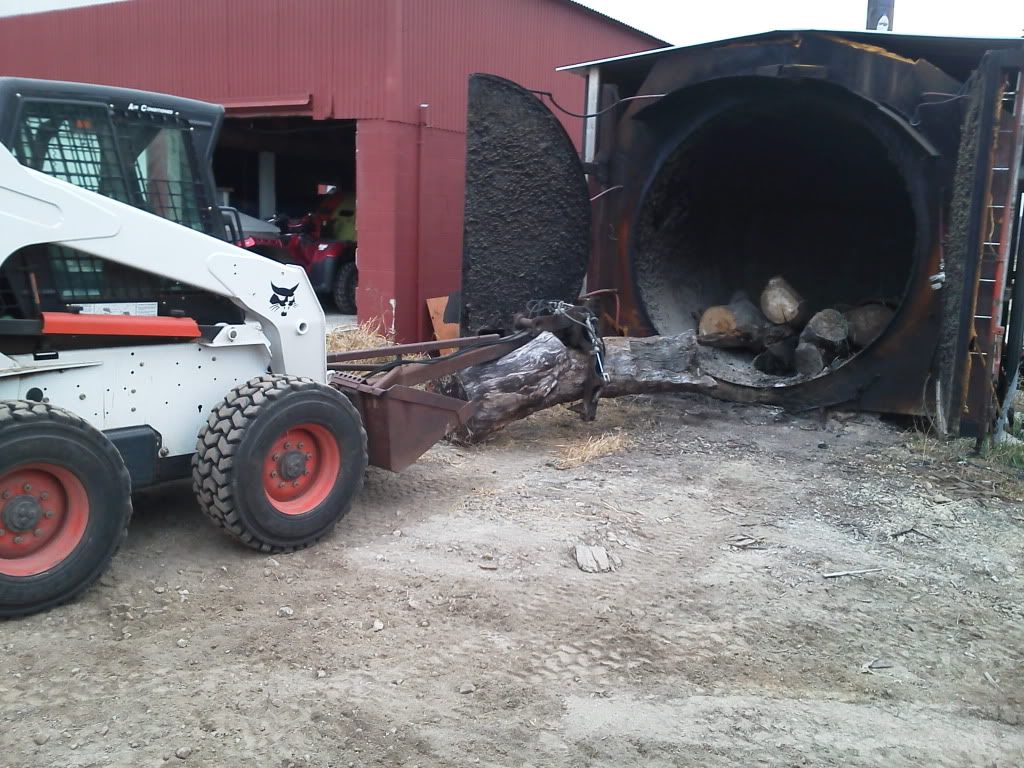

Hello,
I am new here but not new to OWB's. Wondering what the longest run from boiler to house you have heard of? Also what size ID lines? Pumps? How has it performed? I am contemplating a long run over 600ft and looking for real world experience before I dig. I have attached a few pics of some boilers I have built for anyone who cares. Thanks for any responders!

wow that thing is huge! you can drive the bob cat rite in that one!

Coll pics you must live in one of those free States, there is no way you could use one of those in Ma

I recently heard of a District Heating site, where they had a single run of 600' but they were also running 4" supply and return.  I think max length of run depends on your distribution pipe size and your pump.  Definate  :thumbup: on the build; how large is the water jacket, and what kind of BTU's are you pulling.
