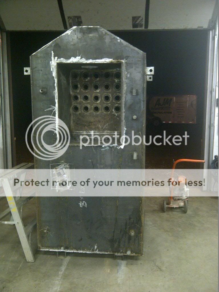

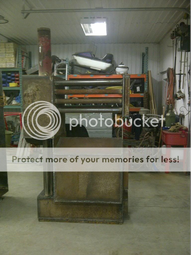

Nice pics, thanks for sharing.
So the square tubes are your air for the burn box and the secondary chamber right?
How is your secondary chamber laid out?  Is it open, or does it route gases to the front and then back using firebrick to separate the space?
Is your nozzle at the back of the burn box?

yes the squares tubes are the primary and secondary air feeds. The primary feeds up over the top of the fire and the secondary branches out to both sides, down the walls to feed in under the firebrick where at that point I cut a hollow in the brick with four veins to feed out at the slot.  The slot is in the middle of the firebox which seems to work very well for even burns in the firebox.
The secondary is mainly open except that I had to put a wall down the center with bricks to support the ceiling layer. this also seems to work well to spread the heat and the ash tends to move to the front and build there before filling the back end. All in all the performance of it seems to be virtually troublefree but I don't have experience with any others either.
