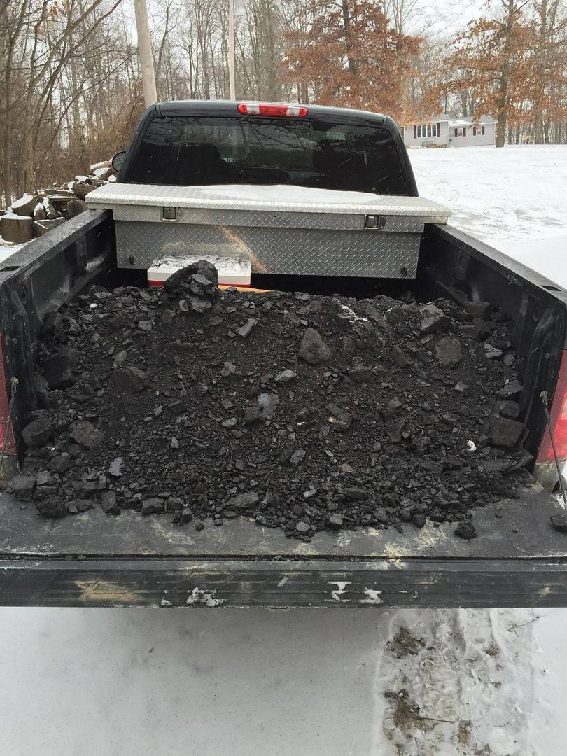

Got some coal to try! Picture added..
« on: February 16, 2015, 04:13:06 PM »
A guy I know who has a trucking company had a pile of coal laying around and told me to help myself. So I went and got about 500 pounds. The only problem is there is a a lot of fines in it along with some softball size pieces. Will it hurt to burn those fines? I have a Hardy H-4. I wanted big lump coal but for this being free I didn't want to pass it up. I'll post a pick later.

Re: Got some coal to try!
« Reply #1 on: February 16, 2015, 09:53:44 PM »
No it wont hurt. I run the fines threw my H4. The only thing I suggest is pile what wood you are burning in the stove then throw your coal on top. I found this to get much better burns and it makes getting the coal lit a little easier. Ive been burning nut coal mixed with almost rice coal and been doing it this way the whole winter. If your just burning coal make sure you have a nice bed of embers before adding coal so it wont fall threw the grates. This way it has somewhere to settle.

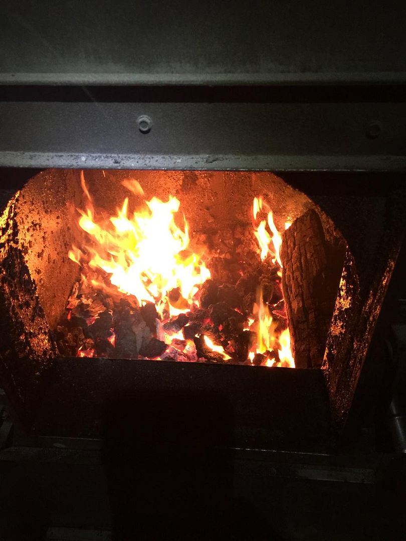

Re: Got some coal to try! Picture added..
« Reply #3 on: February 17, 2015, 04:24:12 AM »
Here it was after 14 hours. I put 6 pieces of wood in and some coal probably 20 pounds. I raked it around as some of it was stuck together. I put 3 pieces of wood in this morning one on either side with 35-40 pounds of coal in the middle with a piece of wood on top. It's -4 here this morning without wind chill heating 1600 square feet with older windows.. Also littleto no smoke this morning until I opened the door.
« Reply #4 on: February 17, 2015, 04:48:45 AM »
Nice does the Hardy have a blower from under the grate?

walkerdogman85
  • Posts: 205
  • OWF Brand: Hardy
  • OWF Model: H-4
« Reply #5 on: February 17, 2015, 07:10:41 AM »
Yeah it has the grates but I do not have the shaker grates in mine. If I end up liking the coal I may buy the shaker grates.
