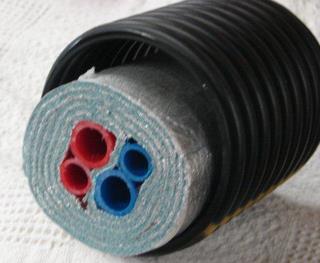

What do you think of this?

By far the best I've ever seen

Looks like Badger 5 wrap.  I paid 8.19 per foot shipped for the 4 line.
