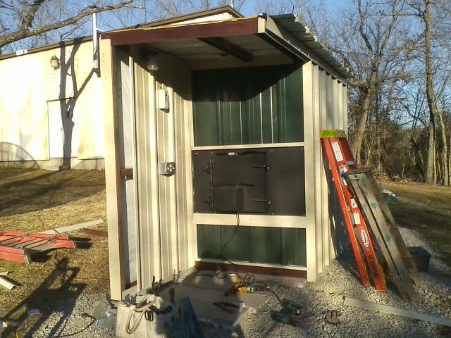

« Reply #42 on: February 16, 2014, 07:21:39 AM »
Here is some "finished" pics.  The door on the back came from an old steel kitchen unit, perfect size.
Since our well water has so much lime in it I am going to fill the system with distilled water, that should happen this week.
Southwest Missouri Ozarks...USA
Re: Homemade "Tank-in-Tank" OWB-Ozarks Hillbilly Edition
« Reply #43 on: February 16, 2014, 07:45:27 AM »
You can buy one time use filters from Central boiler to fill it from your well. Not sure how well they work, but it's CB right? Must work.
I've seen a few manufacturers recommend soft water. Woodmaster dealer in town told me when I built mine to never use soft water as it will contain trace amounts of salt.
Another manufacturer recommends rain water.
WoodMOJoe
  • Posts: 312
  • OWF Brand: Homemade Tank-in-Tank Furnace
  • OWF Model: Ol' Fireball #0002
« Reply #44 on: February 16, 2014, 08:19:46 AM »
I had never seen those CB softener cartridges before, interesting, thanks for posting that.
Looks like they are about $150, that is just about exactly what my 180 gallons of distilled water is going to cost.  I have a 40 gallon plastic barrel, going to pour the 5 gal containers of dist water into it and use a little electric transfer pump to get it into my boiler.
