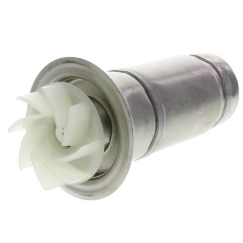

Water quality can make a big difference on how long a pump lasts. Some go out way sooner than that.
Water will still flow through the pump ok even if it was frozen up. Something with the type impeller like Grundfos uses would be better for the pump that is not normally running. The type of impeller that Taco uses will probably cause more restriction. 1st pic is Taco, 2nd is grundfos.

« Reply #21 on: March 17, 2015, 04:59:46 PM »
Thanks,, that's what I wanted to hear.
If the impeller is seized stiff, water can still be pulled through by a second pump down line.
I'm probably gonna do it.
