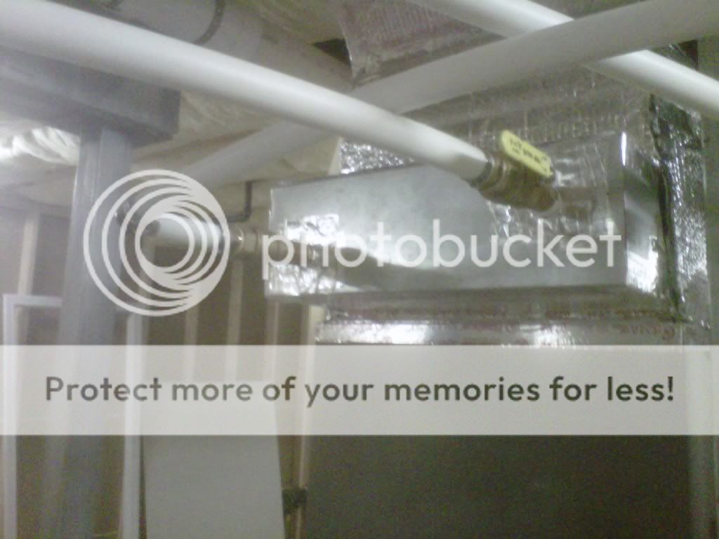

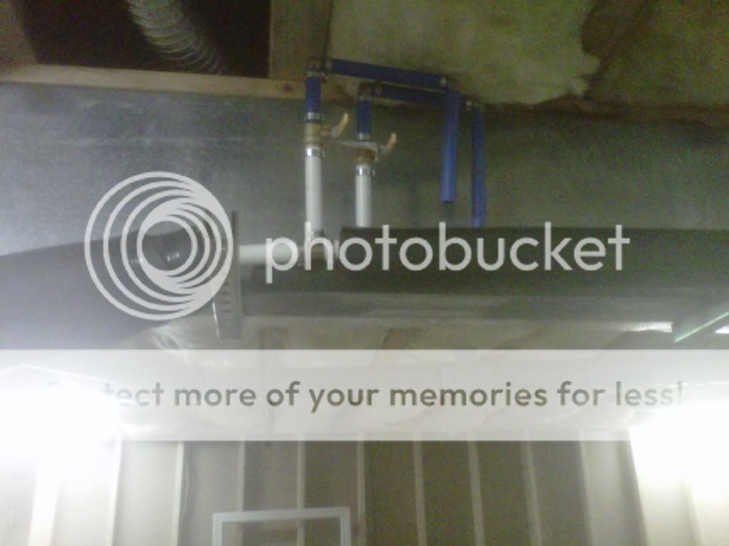

« Reply #36 on: October 07, 2011, 09:00:51 AM »
Nice pics. Finally a post where I can see the pics. (also checked out your links above) NICE JOB!

« Reply #37 on: October 07, 2011, 10:25:06 AM »
i have also seen the pics...and agree..good work

« Reply #38 on: October 07, 2011, 07:07:53 PM »
looks great! :thumbup:
Nice install of your inside piping
Do you need to put a mounting bracket on your plate exchanger to support  the wieght?
I like what you've done

« Reply #39 on: October 08, 2011, 08:03:56 PM »
Thanks all.
No support needed on the plate ex. There's a hanger on the pipe about 18" above it after an ell, and it's cut in right above the water heater.
