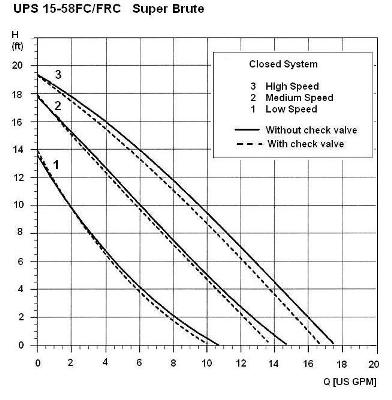

It does restrict flow a little. See flow for a Grundfos 15-58 below.
Also, it can cause the pump to get airlocked in certain situations so best to just remove it if it isn't needed.
