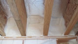

use warm board   my whole house is warm board ,if yours  will be in  a crawl space/ open to the outside  do this.....      ( I have r40 + rim joist/ 2x8 walls)   I took the stupid reflextix/astro foil ( the ONLY use for this stuff PERIOD) stapled it to the under side of the BCI's/ I joists ,leaving the 1.5 space open >> then spray foam it  ... the pic I posted is of my rim joists ...I rolled out the foil stuff then on the ends, I rolled it back in on itself 1' from outside wall  then sealed it with foam ...u could do same then spray the foil with foam ...... .02 cents > although these guys sure liked what I did  http://www.cchrc.org/
