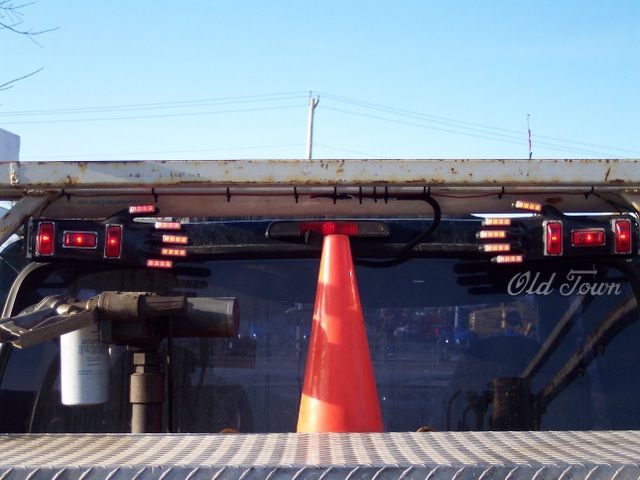

How'd you make ur handle?
Ayuh,....   It's a latex glove mold from an ole factory in S.Carolina....
I grabbed 'bout 50 of 'em when I found 'em...
I just welded a block of aluminum to it, to attach it to the latch...
They also make pretty darn Cool tail lights on a trailer,...
Or,...   3rd brake lights on my pickup,....
I've since that picture built a new mount. so they're center mounted, pointin' outward...
