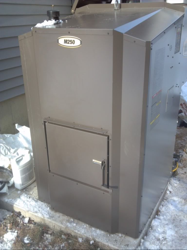

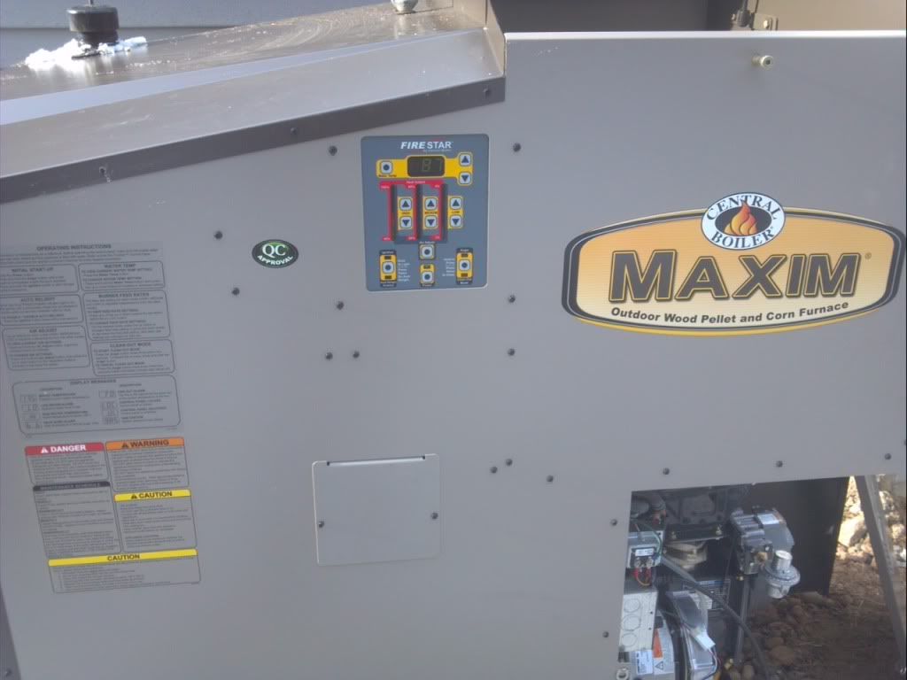

So my dealer emailed me Tuesday saying it just arrived at his shop (an hour away from me).  I asked him he would mind bringing it to me in which he had no problem doing that.  My hope was to have it do it because I had to travel an hour each way to go pick up a bobcat to move it (brother in laws) from slab to bed of truck and back so I was hoping to minimize any more travel.
Dealer brought it by at noon time today..  I am absolutely amazed and impressed with CB right now.  Lets start with the outside..  I can't tell if all the panels were replaced or if they stripped it and repowdercoated it but all 4 sides including the top looks brand new.  They put a new door on, new gaskets (remember this was only a year old boiler).  Obviously they put a new firestar control board in.  Now here is where the amazement starts..  They replaced all electronics and mechanics inside the electrical area.  We are talking wires, fan, pellet auger, fire chamber auger.. EVERYTHING!!  The pellet chamber was completely redone, all new coatings inside of it.  You would never be able to tell that this ever caught fire.
Now my dealer is just amazing..  Besides giving me his demo to use, he drove it to my house for free, gave me a free gallon of the rust inhibitor and test kit.  He did not charge me for the 2 hours he was here with me helping install it.  When I told him I left him a bag and a half of pellets in his demo, he said, "you shouldn't have done that.. I'm not worried about it".  The fact that I used his pellets that were in his unit (leftover) and didn't want me to replace them..  It's just the little things that really mean a lot and a loyal customer.
Here are pictures of the boiler back on my slab.

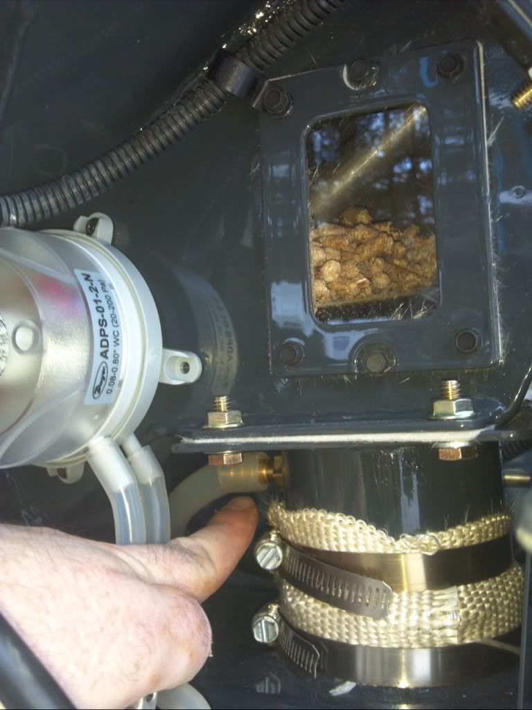

Now here is the interesting part..  CB completely changed the design of the thermovalve...  When did they change this design you may ask..  well, my dealer started getting the new design in December which is a month after they got my burned down boiler at the factory..  Coincidence or more of an Oh Sh%t decision??
If you look where my finger is pointing to, they now have it drilled/tapped and injected directly in instead of a 90* elbow below the glass window.
End result, still no answer from CB yet on what went wrong but the fact that they replaced everything makes me feel more comfortable about using it.. afterall,  if nothing was left, whatever failed is no longer there.. maybe that is why they did replace everything.
Im going to send him a giftcard out to a nice restaurant for him and his wife for all he has done for me.. I think it is the least I can do for him.
