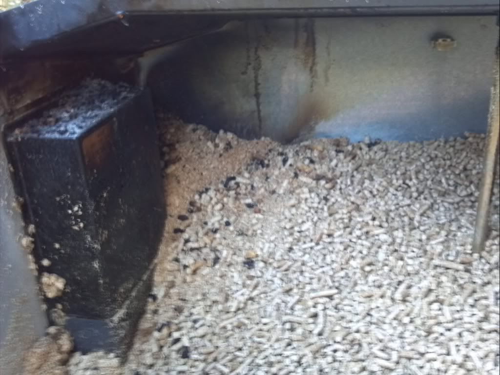

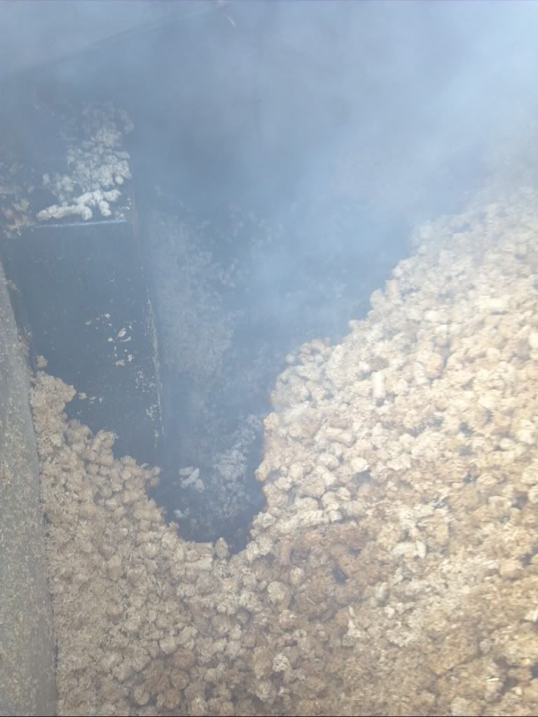

Fire/smoke from pellets
Fire crawling up side by electrical panel
Seals melting and dripping
Control panel burnt as well as corner of hopper.
Control panel melted, orange/red spots burnt into unit from heat.

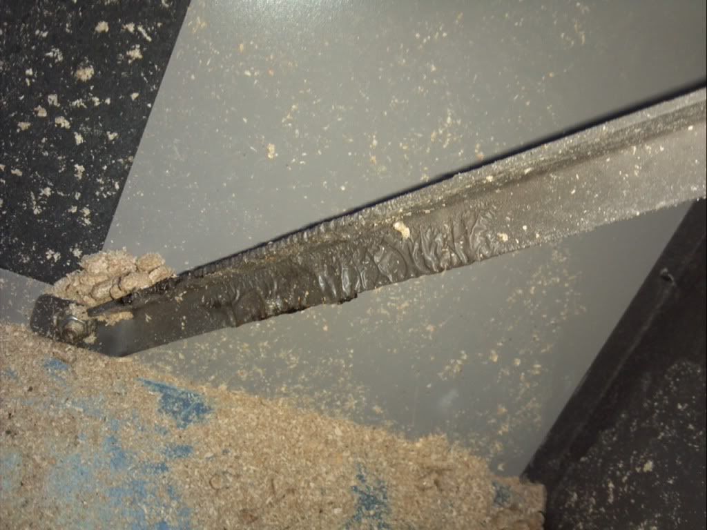

Bottom of hopper - Can see the coating on the right side of pic that melted.
Metal rippling from the heat - no alarm??
500lbs of pellets dumped out
