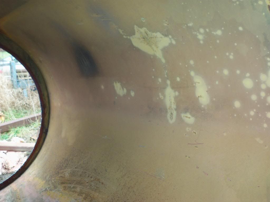

here is the inside of my water jacket after ten years..oxygen scavenger used the first two, after that, nothing.  i can't say that Bondo is right on little oxygen is in your boiler water or not as i really have no idea. although i believe there is oxygen in the water as an open system has no way of keeping it out once removed(again i really have no idea)
but from the picture you can see there was, after ten years of operation, no visable corrosion inside this water jacket. nor was there any on the inside of the fire box. the fire box had rusted through from the inside due to something i had done and i am sure if i had not done what i did, that firebox would still be in operation

perhaps i should clear my last post a bit...i am not saying water treatment is not needed by some (or maybe most) i guess it depends on the type of water you have..i have never had my water tested but it is coming from about 100 feet below the ground where i live. the picture i posted is of the inside of my eater jacket and it show very very little to no corrosion. maybe it was just my luck and perhaps if i had another type of water , sorrosion may have been terrible? this site is for information and i just posted what i saw inside my own home made OWB.
