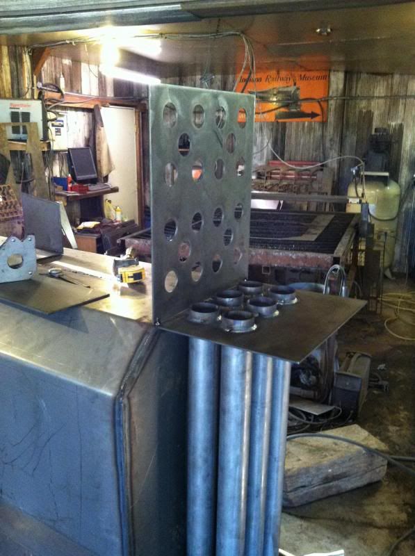

« Reply #6 on: June 30, 2014, 09:06:28 AM »
Well my tubing was in this morning, so I cut the 3" into lengths and tacked onto the mount plate.  Tubing is about 14ga, and looks about spot on as to what I wanted.  Thick enough, but not too thick.  Should be plenty of heat transfer- especially if I slip turbulator strips in later.  The 2" I got for the 2nd/3rd passes is 14ga as well.

Looks good! How are you going to weld the tubes in and weld the bottom plate to the secondary chamber? Doesn't look like enough room between the tubes to weld around them. How do you plan on leak testing this when it is all welded up?
binfordw
  • Posts: 34
Re: Starting Gasification build
« Reply #8 on: July 01, 2014, 11:56:06 AM »
I'll weld the tubes to the plate from the bottom side, then weld the plate to the secondary.  The plates just sitting on the secondary for the photo.
As for leak testing, not sure yet.  It might require making some panels/gaskets to cover the door openings temporarily.  I don't expect much trouble, the steel is all new/clean and welds nice.  If theres a leak it will be a spot I forgot to weld, so I'll need to just pay extra attention.
If I can think up a way to use flanges to mount the doors, then I could easily bolt block off plates/gaskets on the openings to test.  Thats probably my best bet.

There is a spray on dye with a developer that we use at work to check welds. It works good. Don't know what it costs, but I'm sure if you talked to your local welding supply store they might carry it. Welding something to be water tight is not has easy has people think. Stops,starts,and undercut are some of the places you get pin holes.

Cut the bottom of the 2nd/3rd pass access box, and started welding the first pass tubes in.
I understand its not easy, I spent a number of years at a previous job where we repaired alot of large hydraulic pipes, as the large die casting presses shook/shimmied and were jolted with very high pressures.  Currently, the business I work for has a large number of sintering furnaces, with water jacket sections we replace here and there.  Also welded various fluid and air tanks over the years in my home shop and at work.

Finished welding the first pass tubes in, and cut the back of the access box for the 2nd/3rd pass tubes. Probably cut the front access box next so I can get the tubes cut and installed.

Cut the front access box tube plate, so I could start getting the tubes cut up and off my floor.  Looks like I'll need another 8 feet or so of 2" tubing, the lengths were random instead of 20's, so there was more waste than I figured.
