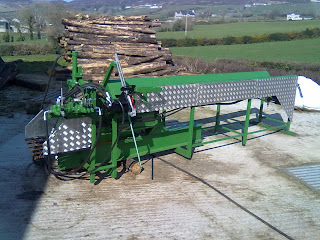

A friend of mine built a splitter last winter and the problem he is having is sometimes it will just run up against wood and not split like mabye the second stage isn't kicking I don't know much about hydros. Its powered by a 14 hp motor if you turn the pressure relief up it will go but he ripped the wedge off after doing that. Ill try to get more details so mabye we can figure this out
Michael West
Central Ohio
walkerdogman85
  • Posts: 205
  • OWF Brand: Hardy
  • OWF Model: H-4
Re: firewood processor build
« Reply #25 on: October 01, 2012, 08:44:35 AM »
here are some pics of it
