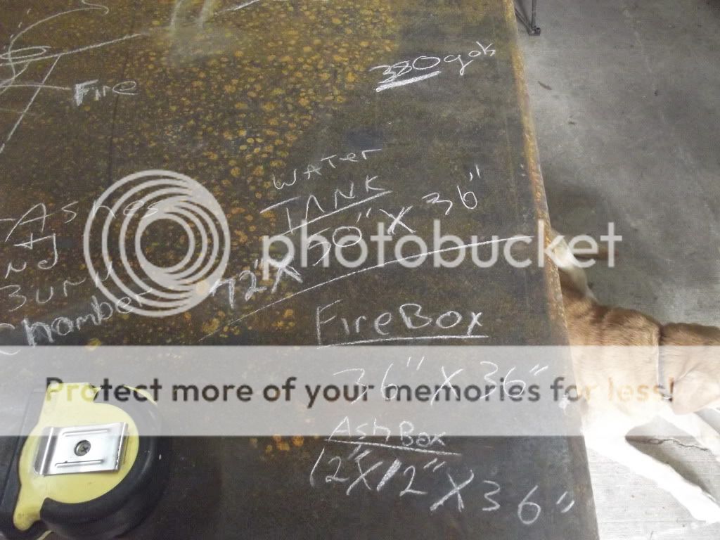

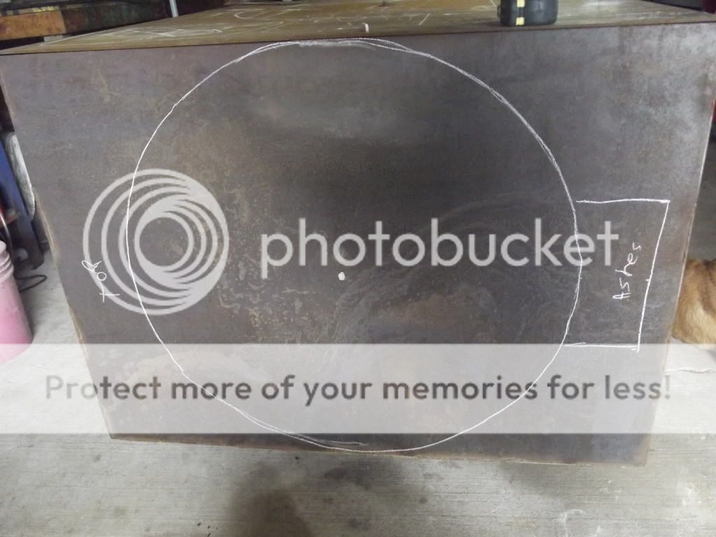

The water tank is 3/16 thick new steel.....Some new parts come in the box and it was left over.....   MY SCORE>>>.....Im having a hard time trying to decide exactly how to put the tank in and work effecient.........I ve drawn on the front to see how it would work and the side.....  I like the side setup plenty deep but not enough/ no water on the sides....36" fire box and 36" tank dont work good....Tank size is 70" tall x 50"  wide x 36" deep.....  With my fire box 36"x 36" and ash pan 12"x12" my water capacity is about 380 gals...   Pretty close to what I Want....  But my stack will have to come out the very back and will not be in the water at all....I plan on putting my stack down in the ash pan.....   Still working on the gasifer part....  Marbles still rolling around in the head..... :bash:

« Reply #12 on: August 09, 2011, 04:41:17 PM »
With that size tank you almost need to find a way to make the firebox oval. You need water on the sides or it will boil there. I doubt it is possible to ovalize the rounded end of the tank so the only way to do it would be to cut it off and do a lot more welding.
How thick is your LP tank? If you could find something the shape of a fuel oil tank it would be a much better fit for your water jacket dimensions.

« Reply #13 on: August 09, 2011, 07:52:40 PM »
have you thought about not pushing the tank ''firebox'' all the way in ,say leave it out 4-5'' that will give you the rear of stove submerged  and alittle bit of stack exiting thru as well.why not run stack up thru water ?
