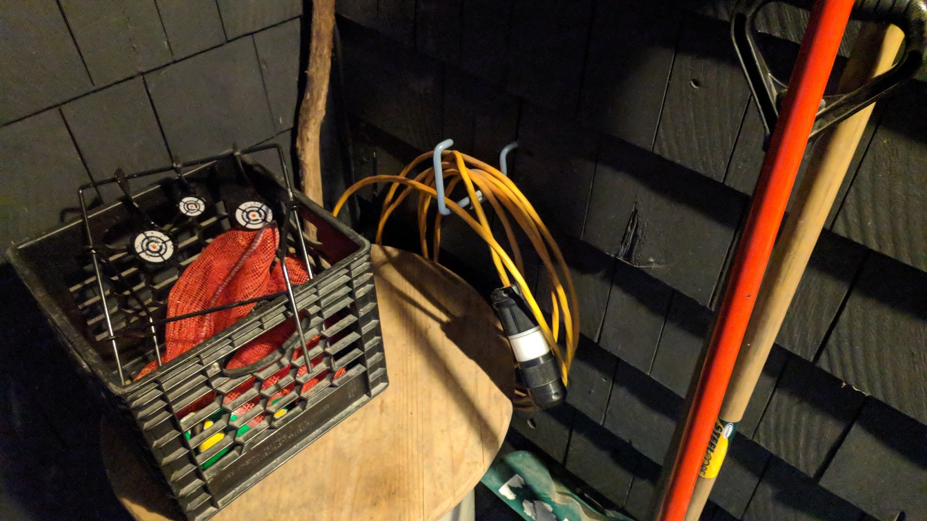

Interlocks? Pshh!  I just have mine backfeed through a 30A 240V breaker from my feed on the corner of the deck...
I guess I did buy the female connector to act as a cap so that if someone turns the breaker on it won't zap ya!   :bag:

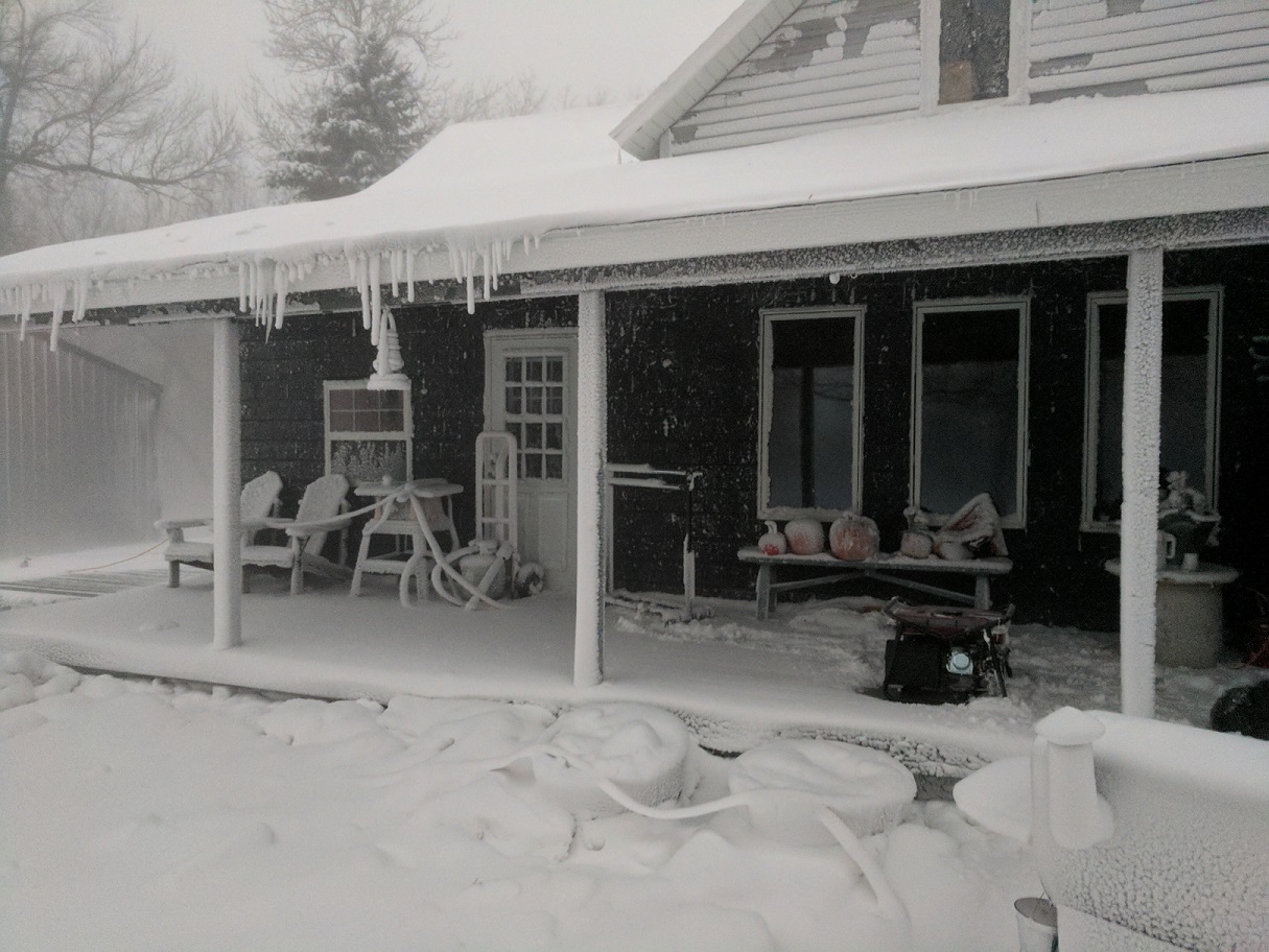

I feed my main panel through a 220V breaker.
Turn my main breaker off and also throw the main breaker on my meter loop.
Have a pole light on the coop side of the meter loop so I can tell when the power comes back at night, neighbor calls if it comes back in the daytime.
Got by in this fashion for 13 days in 2007, quite the ice storm then.
