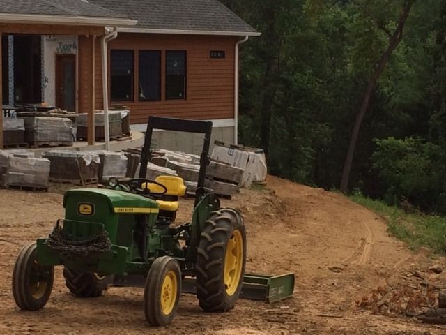

No, no it was my attempt at humor, but there is nothing very level on this lot.  I'm cutting another road along the perimeter of the front of the home to allow me good access from the wood piles to the stove.  I use a tractor with forks so any sideways tilt in the road can be very dangerous.  I will get up a pic of the future front road.   A helicopter would be awful handy though.  :)
I have already cut a road into the wood stove from the back of the house but since the back is our primary entrance, I don't want to mess the yard all up with the tractor...... If that makes any sense.  Here is a shot of the back road I just cut in with ole bessy.
